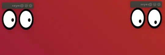

I don't expect this to win "best answer", but there's always the old "xeyes" method.
Placing one at each top corner even lets you triangulate the position.
two sets of animated eyes looking at the cursor

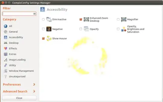

What you want is hidden in the CompizConfig Settings Manager (CCSM) Accessibility settings.
sudo apt install compizconfig-settings-manager
and then:
  • Open CCSM
  • Navigate to Accessibility
  • Click the checkbox before Show mouse
  • Click on Show mouse
  • Click on the first button after Initiate
  • Press a key combination!
    (Ctrl by itself will not work: I have it set to Super+K: the "Windows key" + "K")
  • Click OK
  • Now press the key combination you just took
and it'll show you a flaming whirlwind of stars around your cursor impossible to miss:
