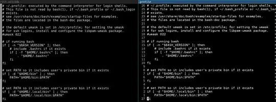

Here is a side-by-side screenshot of urxvt (left) vs. emacs (right). emacs' font is slightly crisper. I'll admit the difference doesn't look that impressive, but at work I use a 4K monitor with the resolution set to 1920x1080, and for whatever reason the difference is much more pronounced.
Screenshot

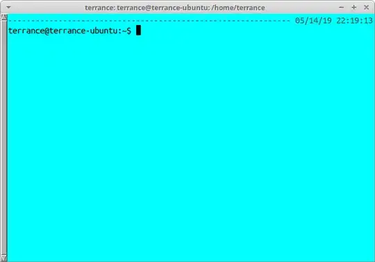

After you launch urxvt it should look something like the following:
Hope this helps (some)!
