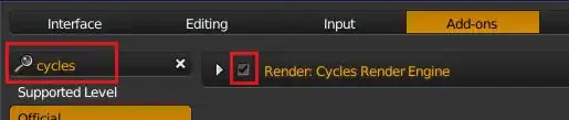

While cycles is an official part of blender, it is technically being provided as an addon.
The cycles addon needs to be enabled for it to be available. Open File->User Preferences and find the cycles addon and enable it.
enabling the cycles addon
If cycles cannot be found in the addons list, then you may have deleted blenders addon files and should look at re-installing blender.
