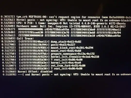

I can't boot the 4.4.0-146-generic kernel because of a kernel panic. I'm running 16.04.6 on an Intel Core i7-7500U CPU @ 2.70GHz × 4. See image below:
Kernel panic booting 4.4.0.146

Try to boot your Linux from the live CD/DVD, into the recovery mode prompt, then check your root fs, e.g.
fsck /dev/your_drive
Note: Add -y to fix any errors automatically.
Or:
chroot /mnt/sysimage
fsck -y /dev/mapper/dom0_root
Source: Kernel panic - not syncing: VFS: Unable to mount root fs on unknown-block.

The usual cause can be:
  • Broken grub config.
  • Root partition not flagged as bootable.
  • Bad installation (initramfs lacks or uses modules of another kernel version).
  • Bad RAM, try replacing. See: Random Kernel Panic on boot - not syncing.
You can try to fix your Grub record by:
  1. Mount your LXLE /boot partition (for instance at /mnt/boot).
  2. Install Grub bootloader by: grub-install --boot-directory=/mnt/boot /dev/sdX
  3. Then run: grub-mkconfig -o /mnt/boot/grub/grub.cfg.
  4. Optionally, if it fails to detect your other system, edit grub.cfg file manually.
Source: Kernel Panic on first boot.
