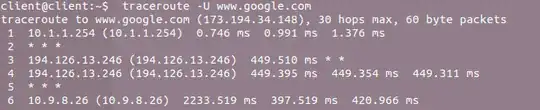

you can use traceroute with both a normal user and a superuser that depends on the option you want to use , here is an example :
Here we are using UDP packets which doesn't need superuser privileges
Here we are using ICMP echo packets which need privileges .
