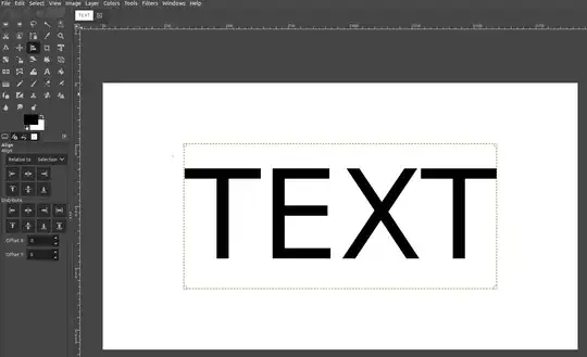

I've found solution:
  1. On the empty art-board type text
  2. Chose Alignment tool
  3. Select text object pressing on it by left mouse key you'll see mini squares on the corners of selection
  4. Use Alignment tool instruments to align text to art-board
screenshot of GIMP
I spent many time and realized that i missed 3-rd step. Select text object by clicking mouse, very important step. For me, Ctrl+A or other selections didn't work.
