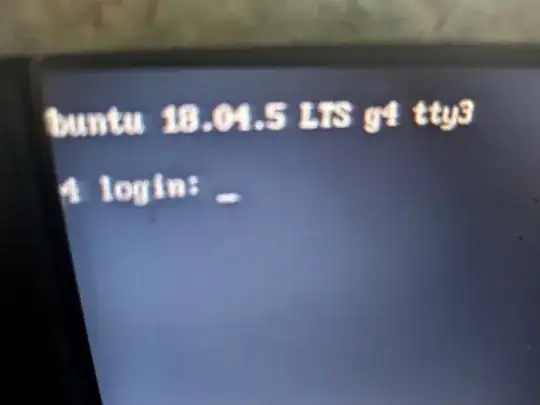

  • Ctrl+ Alt_+F3 and login to the session. Ctrl+ Alt_+F3  output
  • Check if you can run any shell command like ls. If not, then that's the problem.
  • Type /usr/bin/sudo /usr/bin/vim /etc/environment
  • Use your knowledge of vim to delete the line that you added.
  • You can use any other non-GUI editor if you know the path to that editor's executable.
  • Save the file ':wq for vim'.
  • type poweroff
  • You would get some command suggestion like/sbin/poweroff.
  • Use it to power off or you can simply pull the plug.
  • Restart and you are done.
