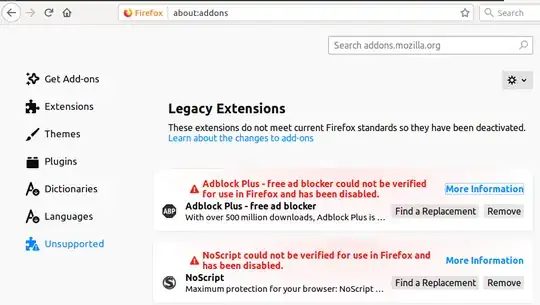

This morning I woke up to:
Extensions disabled
and the FireFox help page doesn't really help...
Help! What should I do now???
I need NoScript and AdBlock Plus to improve my surfing speed!!!

Just open a new tab and go to about:config and filter on signatures.required and double click both of them to turn them from true to false:

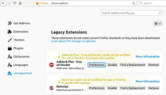

Nasty Red
and the nasty red turns into a fine yellow:
Nice Yellow
Which allows me to move on for the moment, until:
