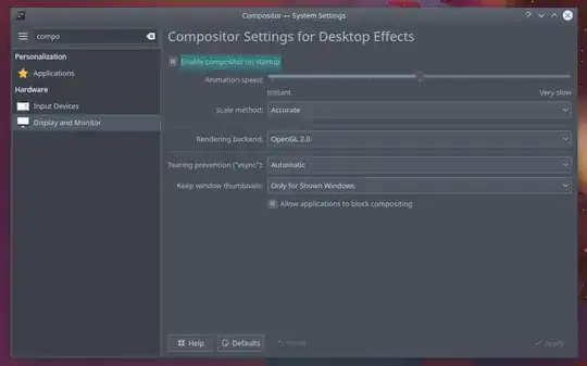

Alternatively, use the GUI to ensure that compositing is turned on when the system starts:
Set compositing enabled on startup
