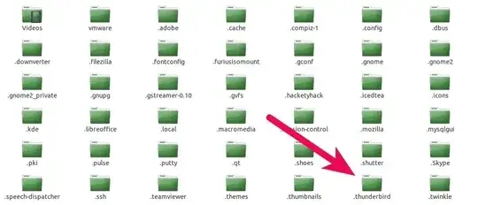

Go to your home folder & press " ctrl + h " to view hidden folders
copy & backup " .thunderbird " folder
Inside .thunderbird you should see a bunch of files and folders named Cache, Mail, ImapMail etc
