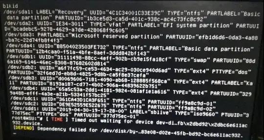

blkid
cat /etc/fstab
dpkg -l *nvidia*

You've got a problem with your swap partition.
Screenshots or images make it a little difficult to give a 100% complete answer, but I'll give you the basics and that should be enough.
The /etc/fstab has a line where it tried to mount swap. It fails because the UUID that ends in c932 is incorrect. We have to edit /etc/fstab and replace that incorrect UUID, with the UUID that we see in the sudo blkid command... using the /dev/sdb1 UUID that ends in 18cf.
Boot to recovery mode and enter this command(s):
sudo mount -o rw,remount / # assure the disk is r/w
sudo blkid | grep sdb1 # show us the correct UUID
copy this UUID to the clipboard
sudo pico /etc/fstab # edit fstab
replace the bad UUID on the swap line, with edit/paste
control+o and return to save the edit
control+x to exit the editor
reboot # reboot the computer
