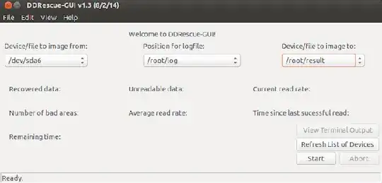

DDRescue can make an image of the damaged hdd despite reading errors
In case of complete hardware failure, there is nothing to do else of an hardware intervention. In many cases, the electronic board of the hard-drive is failing, disks and other mechanical parts are ok. So, if you can find an identical drive, you can switch pcbs and have the hdd running again... But that is a bit tricky.
The software solution will be to make an image of the damaged hdd despite reading errors. DDRescue was made for this.
Once booted from USB Live Ubuntu, simply install -to ram- the required software, plug-in another external media and save on it an image of the failing hdd.
You have two options:
- Text mode with gddrescue package
- Graphical mode with ddrescue-gui package
1/ Graphical mode
ddrescue-gui
# Graphical Mode:
# Boot with live usb
# Install DDRescue graphical
sudo add-apt-repository ppa:hamishmb/myppa
sudo apt-get update
sudo apt-get install ddrescue-gui
2/ Text mode
# Text mode:
# Install gddrescue
sudo apt install gddrescue
