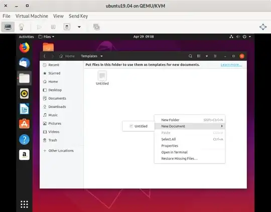

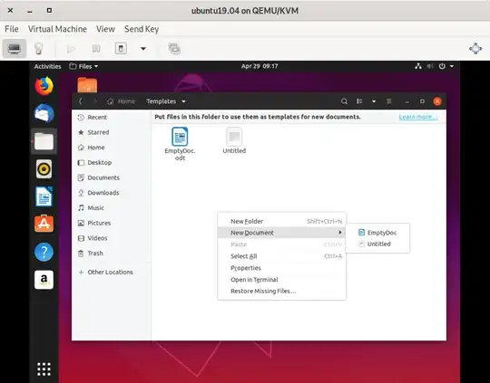

You can enable the "New Document" context menu item by creating templates in the ~/Templates folder. These templates should be empty documents, unless of course you always wish to start with some pre-entered data.
For example,
  1. start gedit, the text editor
  2. Press "Save" and save the document as 'untitled' in "/home/username/Templates"
  3. Open nautilus the file manager
  4. Right click in an emty area of the file manager, and the context menu will now allow you to create a new, empty text document.
This will also work with the various LibreOffice document types, and I suspect many others.
