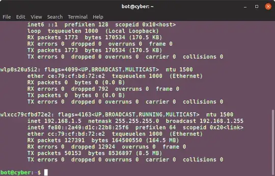

ifconfig screenshot:

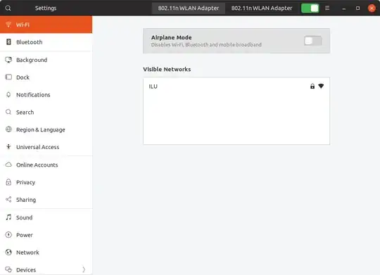

Gnome wifi option:

I assume that you downloaded the usual driver from the lwfinger git repository. If this is so, please open a terminal and change directories to the location of the files:
cd ~/Desktop/rtl8723bu
Or wherever you downloaded the file, if not Desktop.
Let's clean up the old driver files:
make clean
And update the driver with any changes:
git pull
In the README.md, concurrent mode is explained:
Concurrent or Non-Concurrent Mode
By default driver operates the hardware as a station AND as an access point simultaneously. This will show two devices when you run the
iwconfigcommand.If you do not want two devices (station and an access point) simultaneously, then follow these instructions.
Step 1: Run the following command in the Linux terminal.
nano MakefileStep 2: Find the line that contains
EXTRA_CFLAGS += -DCONFIG_CONCURRENT_MODEand insert a#symbol at the beginning of that line. This comments that line and disables concurrent mode.
Now run:
make
sudo make install
Reboot.
