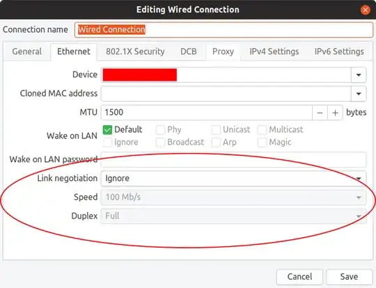

In terminal, use the nm-connection-editor, set the "Link negotiation" to "manual/100Mb/full".
