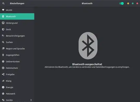

So my bluetooth was working fine until last week where a new update came along. I'm guessing this included a kernel update. Then, my bluetooth was disabled and I can't turn it on again.
The service is running but in the switch in gnome-control-center does nothing when hit.
