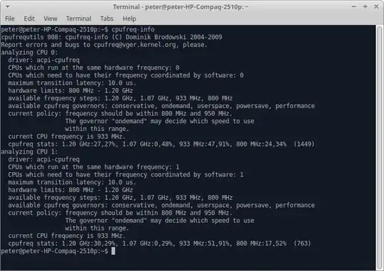

Is there a way to delete the old stats for a fresh start? I have set max CPU-speed to 950 MHz in file cpufrequtils. My issue is that this limitation is not in action when booting up, during which cpufrequtils is collecting data as can be seen from output: cpufreq stats: 1.20 GHz:27,27%. So after boot i would like to reset the stats to zero.
peter@peter-HP-Compaq-2510p:~$ cpufreq-info
cpufrequtils 008: cpufreq-info (C) Dominik Brodowski 2004-2009
Report errors and bugs to cpufreq@vger.kernel.org, please.
analyzing CPU 0:
  driver: acpi-cpufreq
  CPUs which run at the same hardware frequency: 0
  CPUs which need to have their frequency coordinated by software: 0
  maximum transition latency: 10.0 us.
  hardware limits: 800 MHz - 1.20 GHz
  available frequency steps: 1.20 GHz, 1.07 GHz, 933 MHz, 800 MHz
  available cpufreq governors: conservative, ondemand, userspace, powersave, performance
  current policy: frequency should be within 800 MHz and 950 MHz.
                  The governor "ondemand" may decide which speed to use
                  within this range.
  current CPU frequency is 933 MHz.
  cpufreq stats: 1.20 GHz:27,27%, 1.07 GHz:0,48%, 933 MHz:47,91%, 800   MHz:24,34%  (1449)

  cpufreq stats: 1.20 GHz:30,29%, 1.07 GHz:0,29%, 933 MHz:51,91%, 800  MHz:17,52%  (763)
