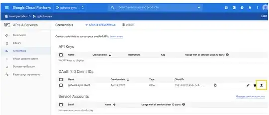

In the menu bar, go to Credentials, Create Credentials, OAuth ClientID.
Select type Desktop Application and give the client a name. I used gp_client.
You'll see a confirmation screen. Afterwards, use the download arrow button to save the file as client_secret.json:
I saved it in my ~/Downloads folder and then moved it to the correct folder for gphotos-sync, creating it if it does not exist:
the client_secret.json file has to be named as here.
