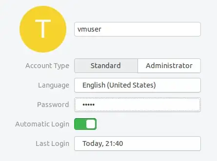

It is not recommended to run a virtual machine as root and Virtual Box is not designed to do so. This is why a virtual machine always needs to be started from a user session.
If you need to run this session after boot you may enable auto-login for a user running your virtual machines as startup application.
