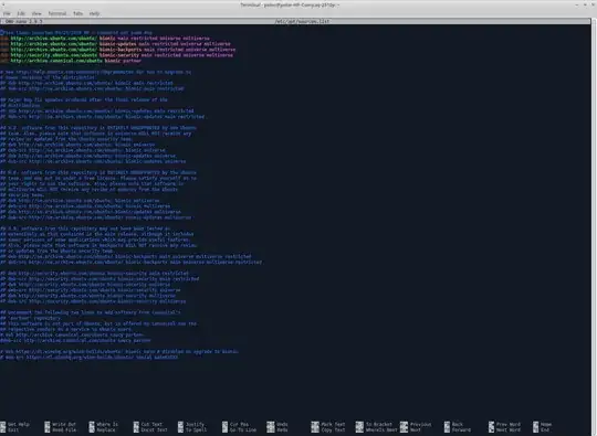

Edit: As suggested by karel, I commented out the following line in source.list: #deb-src http://archive.canonical.com/ubuntu saucy partner. Now only four items remains to be addressed.
peter@peter-HP-Compaq-2510p:~$ sudo nano /etc/apt/sources.list
peter@peter-HP-Compaq-2510p:~$ sudo apt-get update
Hit:1 http ://se.archive.ubuntu.com/ubuntu bionic InRelease
Hit:2 http ://se.archive.ubuntu.com/ubuntu bionic-updates InRelease
Get:3 http ://se.archive.ubuntu.com/ubuntu bionic-backports InRelease [74,6 kB]
Get:4 http ://security.ubuntu.com/ubuntu bionic-security InRelease [88,7 kB]
Fetched 163 kB in 4s (43,1 kB/s)
Reading package lists... Done
Edit: Trying to solve the problem by change in sources.list in accordance to advice given by karel.
peter@peter-HP-Compaq-2510p:~$ cat /etc/apt/sources.list
#Five lines inserted 04/25/2019 #P = commented out same day
deb http://archive.ubuntu.com/ubuntu/ bionic main restricted universe multiverse
deb http://archive.ubuntu.com/ubuntu/ bionic-updates main restricted universe multiverse
deb http://archive.ubuntu.com/ubuntu/ bionic-backports main restricted universe multiverse
deb http://security.ubuntu.com/ubuntu bionic-security main restricted universe multiverse
deb http://archive.canonical.com/ubuntu bionic partner
# See http://help.ubuntu.com/community/UpgradeNotes for how to upgrade to
# newer versions of the distribution.
#P deb http://se.archive.ubuntu.com/ubuntu/ bionic main restricted
#P deb-src http://se.archive.ubuntu.com/ubuntu/ bionic main restricted
## Major bug fix updates produced after the final release of the
## distribution.
#P deb http://se.archive.ubuntu.com/ubuntu/ bionic-updates main restricted
#P deb-src http://se.archive.ubuntu.com/ubuntu/ bionic-updates main restricted
## N.B. software from this repository is ENTIRELY UNSUPPORTED by the Ubuntu
## team. Also, please note that software in universe WILL NOT receive any
## review or updates from the Ubuntu security team.
#P deb http://se.archive.ubuntu.com/ubuntu/ bionic universe
#P deb-src http://se.archive.ubuntu.com/ubuntu/ bionic universe
#P deb http://se.archive.ubuntu.com/ubuntu/ bionic-updates universe
#P deb-src http://se.archive.ubuntu.com/ubuntu/ bionic-updates universe
## team, and may not be under a free licence. Please satisfy yourself as to
## your rights to use the software. Also, please note that software in
## multiverse WILL NOT receive any review or updates from the Ubuntu
## security team.
#P deb http://se.archive.ubuntu.com/ubuntu/ bionic multiverse
#P deb-src http://se.archive.ubuntu.com/ubuntu/ bionic multiverse
#P deb http://se.archive.ubuntu.com/ubuntu/ bionic-updates multiverse
#P deb-src http://se.archive.ubuntu.com/ubuntu/ bionic-updates multiverse
## N.B. software from this repository may not have been tested as
## extensively as that contained in the main release, although it includes
## newer versions of some applications which may provide useful features.
## Also, please note that software in backports WILL NOT receive any review
## or updates from the Ubuntu security team.
#P deb http://se.archive.ubuntu.com/ubuntu/ bionic-backports main universe multiverse restricted
#P deb-src http://se.archive.ubuntu.com/ubuntu/ bionic-backports main universe multiverse restricted
#P deb http://security.ubuntu.com/ubuntu bionic-security main restricted
#P deb-src http://security.ubuntu.com/ubuntu bionic-security main restricted
#P deb http://security.ubuntu.com/ubuntu bionic-security universe
#P deb-src http://security.ubuntu.com/ubuntu bionic-security universe
#P deb http://security.ubuntu.com/ubuntu bionic-security multiverse
#P deb-src http://security.ubuntu.com/ubuntu bionic-security multiverse
## Uncomment the following two lines to add software from Canonical's
## 'partner' repository.
## This software is not part of Ubuntu, but is offered by Canonical and the
## respective vendors as a service to Ubuntu users.
# deb http://archive.canonical.com/ubuntu saucy partner
# deb https://dl.winehq.org/wine-builds/ubuntu/ bionic main # disabled on upgrade to bionic
# deb-src https://dl.winehq.org/wine-builds/ubuntu/ xenial mainGXGXG
Hit:1 http://archive.canonical.com/ubuntu bionic InRelease
Get:2 http://security.ubuntu.com/ubuntu bionic-security InRelease [88,7 kB]
Hit:3 http://archive.ubuntu.com/ubuntu bionic InRelease
Hit:4 http://archive.ubuntu.com/ubuntu bionic-updates InRelease
Get:5 http://archive.ubuntu.com/ubuntu bionic-backports InRelease [74,6 kB]
Fetched 163 kB in 2s (84,5 kB/s)
