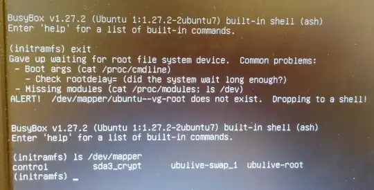

  7. Bad news: After asking me for the encryption password, Ubuntu drops me to the busybox/ash/initramfs command prompt
  8. I booted the live USB again, renamed back with vgrename tkr3Cj-xxx ubuntu--vg-root. I confirmed that I can see my encrypted files by typing sudo mount /dev/ubuntu--vg-root/root /media/somefolder. Then I unplugged the USB and rebooted.
  9. Bad news: After entering the encryption password, I still get dropped to busybox.
Question: How to make it boot normally again?
In particular, why does Grub still see the mistaken volume name "ubulive" even though from the live USB all I can see is "ubuntu--vg-root"?

Instead of vgrename tkr3Cj-xxx ubuntu--vg-root, run this command:
vgrename tkr3Cj-xxx ubuntu-vg
With that, Ubuntu booted and mounted the encrypted disk flawlessly.
It seems that the -root part and the doubling of the - happen somewhere in the process.
Nicolas Raoul
  • 11,921
you need remake the grub conf.
when you rename a vg volume, the lvm do not update the grub.conf.
if you edit /boot/grub/grub.conf, you will see the old names of groups/logical, then rename then with sed:
sed -i 's/old_vg_name/new_vg_name/g' /boot/grub/grub.conf
