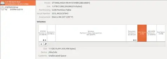

My hard disk is not partitioned in order. When I use the disks application on ubuntu, it says that /dev/sda is free space. Here is a picture of the disks gui. Disks gui for my system
From left to right, the partitions shown in the image are /dev/sda1, /dev/sda2, /dev/sda3, /dev/sda5, /dev/sda, /dev/sda4 and then /dev/sda again.
