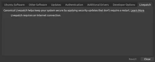

In Software & Updates / Livepatch I get this notification "Livepatch requires an internet connection." with a disabled switch in front of it. I am online so internet connection is up & running.
Screenshot Software & Updates:
screenshot Software & Updates

19.04 does not offer livepatch(?).
My 19.04 claims:
Livepatch is not available for this release.
Maybe it was intended to work but they cancelled it (again as they did with 18.10).
An Ubuntu One account is required. And a token. And since you have a token I'd assume it does not work (yet) for 19.04.
The wiki Kernel Livepatch only points to LTS so the websites that show what is new are probably wrong or got wrong information from Canonical.
