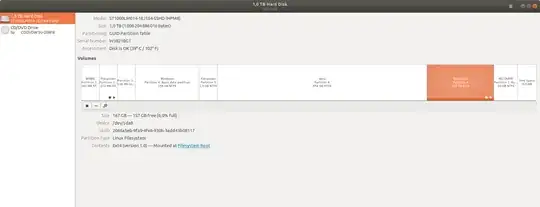

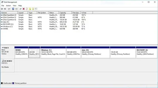

Attached screenshots of my partitions, there are Windows partitions, one for my files, and one for Ubuntu. Grub is installed on sda. The one called RECOVERY I don't know what it is, I'm sure it wasn't there before.
Partitions seen in Ubuntu partitions seen in Ubuntu
Partitions seen in Windows partitions seen in Windows
