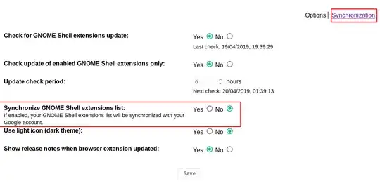

You're probably using the browser extensions (available for Firefox and Chromium/Chrome) that helps to install GNOME shell extensions from extensions.gnome.org.
These extensions also let you sync your list of extensions. Open preferences of the extension and enable the 'Synchronise GNOME shell extensions list' option:
and click 'Save'.
