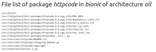

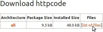

Also for not installed package one can visit https://packages.ubuntu.com and use Search package directories here (for all releases or for selected release), then click on list of files link in the right column of the table:
list of files link
and one will get the file list:
list of files for httpcode package
This list may interpreted manually or by using searchbar in the browser.
