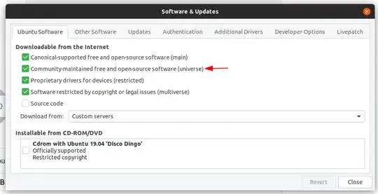

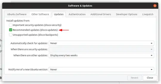

  1. Press on left/bottom corner on 'show applications' or 'windows button'
  2. Open Software & Updates
  3. Make sure you have these 2 checked Update Software -> universe
Updates -> disco-update 4. Close(update) 5. Restart Enjoy :)
