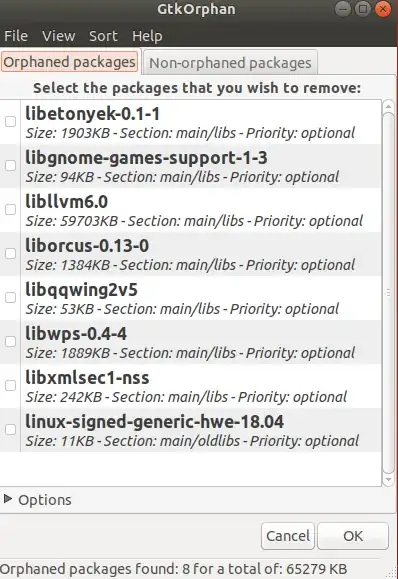

After running GtkOrphan it provides a list of 8 packages suggested for removal.
Are there likely to be any undesirable consequences in removing any of these using the tools provided within the utility?

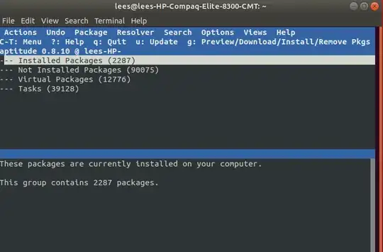

Running aptitude from the terminal with no parameters produces:

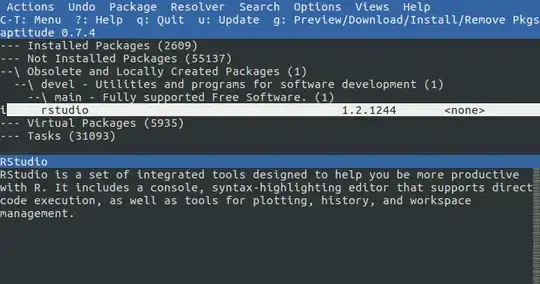

or do not use GtkOrphan at all and rely on Aptitude with its Obsolete and Locally Created Packages
aptitude orphaned
or aptitude search '?obsolete':
i   rstudio                         - RStudio
