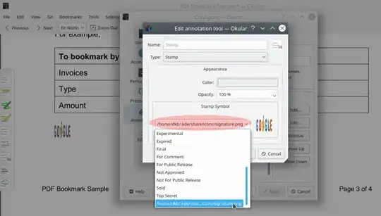

First, please place your image in ~/.kde/share/icons, creating the icons folder if need be. (To be on the safe side, please use lowercase for the image name and avoid spaces).
Adding your own stamp in Okular
Then, as shown in the image above, you need to type or paste in the entire path and filename like
/home/rundekugel/.kde/share/icons/mysignature.png
assuming that your username is rundekugel and that mysignature.png is the relevant image.
This is a recognized usability issue in Okular version 1.3.3 that ships in Bionic and is being addressed in Make custom stamp image support more discoverable.

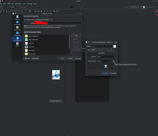

With more recent versions of Okular, there seem to be an easier solution for this task.
I am using Okular 23.04 and this works for me:
Go to Settings -> Configure Okular... -> Annotations -> Add -> Select Type: Stamp -> Choose symbol file from your file system using the file picker button.

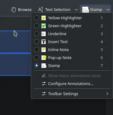

You can use your new Stamp by clicking on this button in the top-right toolbar corner and selecting it from the drop-down menu.
