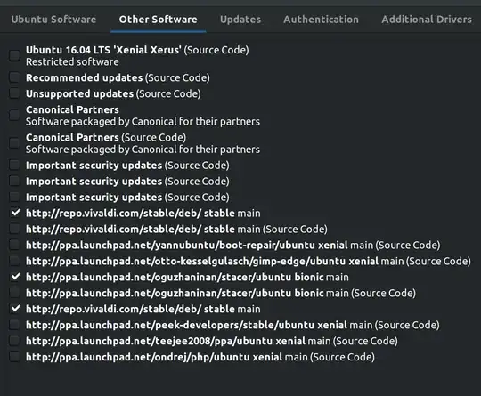

I have remove the disabled APT repositories, but as suggested here Remove APT repositories disabled after upgrade to 18.04 I didn't do this:
"Some of the disabled repositories may have "xenial" in the text. You will need to replace "xenial" with "bionic" before you enable them so that they point to the right repository version."
Which APT I need to add, this is my current list of APT:

Considering you are upgraded from Xenial to Bionic, the repositories you own must have listed as Xenial version, you can simply all occurance of Xenial to Bionic.
sudo sed -i "s/xenial/bionic/g" /etc/apt/sources.list
sudo apt update
Also, creating a brand new source list may help. This will rename the old source list to sources.list.bak (in which you can return anytime), and create new sources.list—fill them with four main Bionic repository.
sudo mv /etc/apt/sources.list /etc/apt/sources.list.bak
echo "deb http://archive.ubuntu.com/ubuntu bionic main restricted multiverse universe" | sudo tee -a /etc/apt/sources.list
sudo apt update
