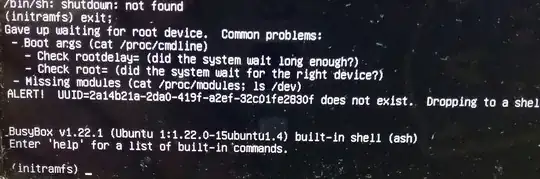

It's happand after the laptop is accidently shutdown when battery is dry. Theb when I try to start the laptop it always show blank purple screen.
So I tried to select option "advance option" then select recovery. But the terminal show this:
ubuntu busybox v1.22.1 initramfs uuid xxxxx not exist
After strugling with tutorial around Askubuntu and from another sites unfortunately it still the same.
