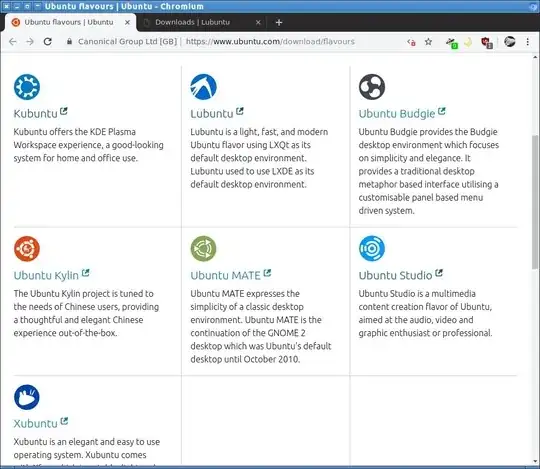

Official flavors however still support x86/i686/32-bit for 18.04 LTS and can be downloaded from https://www.ubuntu.com/download/flavours
flavors web page

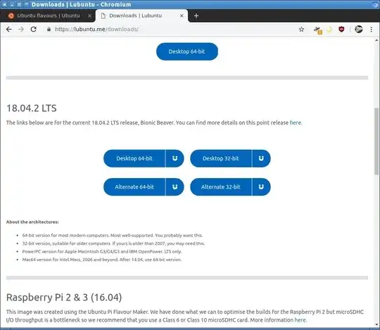

Clicking on the Lubuntu option you'll eventually get to this page where that flavor can be downloaded in x86/i686/32-bit lubuntu 18.04 download options
Note: I'm using Lubuntu only as an example - most (if not all) other flavors also supported 32-bit at 18.04, and Lubuntu & Xubuntu also supported installing x86 for 18.10 installs
