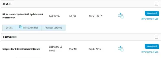

Update your BIOS, and your HDD firmware.
To check your BIOS version:
sudo dmidecode -s bios-version
To check your HDD firmware, try:
sudo lshw -C disk
Go to this HP Support web site and download these two files...
Update #1:
  • you can't update the HDD firmware, as you don't have a Seagate HDD
