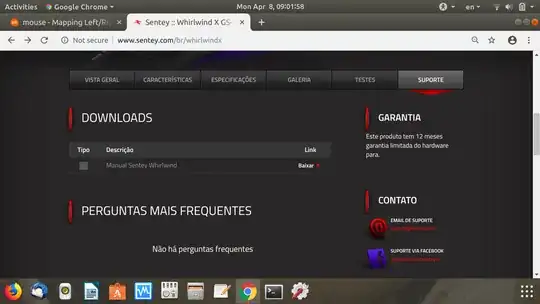

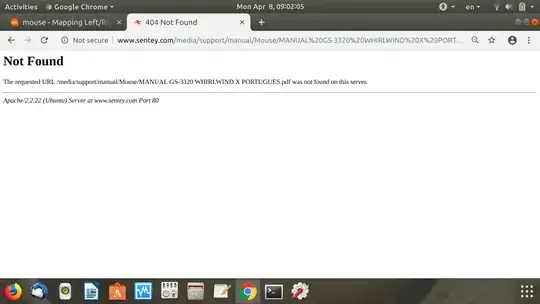

According to the website of your mouse vendor http://www.sentey.com/br/whirlwindx there should be a software for configuring side buttons but i did not find any link to it. Also the support for this mouse is only to the OS'es Windows & MacOs it seems.
