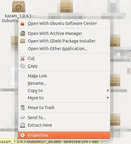

To make it default for deb handling, follow these steps

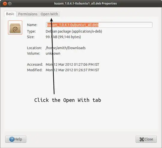

Right click on any .deb file and click properties

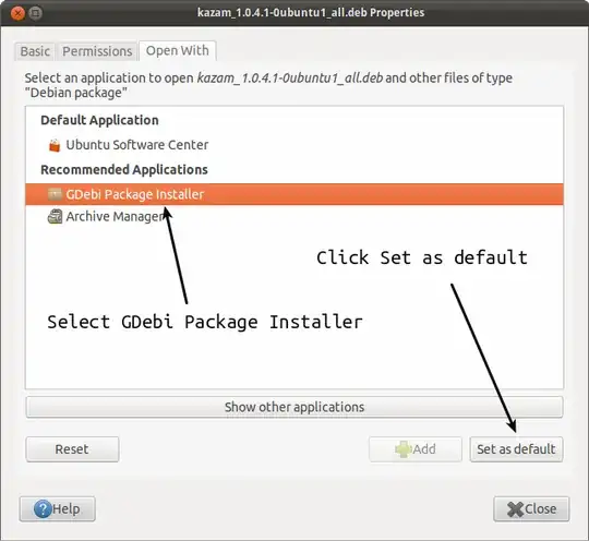

Go to the Open With Tab
Select Gdebi Package Installer and click Set as default
