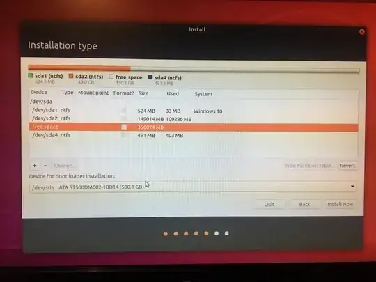

I am installing Ubuntu and I want to do it on "free space" on my disk, but I don't know how.
This is what I have:
This is what I have.
Please help me to figure this out.

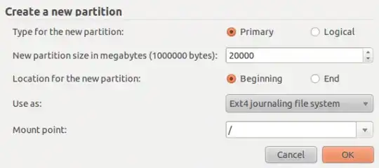

All operating systems need to be installed on a disk partition so that the disk can keep track of where things are. Hence, in order to install Ubuntu, you need to create a new disk partition, which you can do with the [+] button in the lower-left corner.
When you create this disk partition, you should ensure that it's marked to be mounted at root, and that it has a file system. Take a look at the details of this dialog:
You can see that a file system (Ext4, journaling file system) has been chosen for the partition, and also that the partition has been chosen for mounting at / (that is, the file system root).
(You don't have to have a single disk partition mounted at the filesystem root (/), although this set-up works completely fine for most users. An example of an alternative set-up would be one disk partition mounted at / and a second partition mounted at /home. This allows for all system data (applications, system software and configuration files) to be stored on a separate partition to user data, which can be useful -- for example, if storage space on a fast storage device is limited, it might be possible to run a fast system by placing system data on the fast storage device, and using a larger but slower storage device for user data (which is accessed far less often).)
If you plan to dual boot Ubuntu with Windows, you should be fine: when you install Ubuntu, it will install the GRUB bootloader automatically. GRUB should detect any and all other operating systems on your computer, including Windows. If it doesn't, you can fix it.
