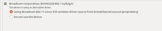

Here's what I have tried: I have run sudo apt-get update and in my 'Software and Updates' -> Additional Drivers, i have selected the Broadcom drivers. I booted the system and none of this seems to work. What can I do?
