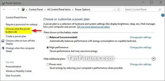

  2. Click on the Choose what the power buttons do link on the left side. (see screenshot below)

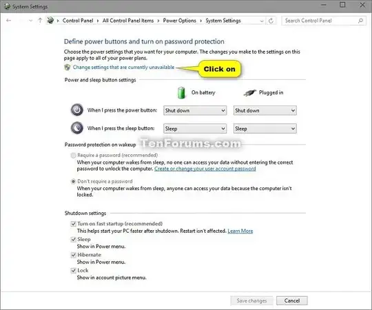

  1. Click on the Change settings that are currently unavailable link at the top. (see screenshot below)

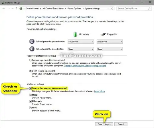

  1. Under Shutdown settings, uncheck the Turn on fast startup box, click on the Save changes button. (see screenshot below)
