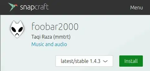

The new Snap for foobar2000 works excellent, and frankly makes installing foobar2000 on Ubuntu tons of easier.

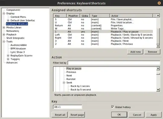

But as expected, the "Global hotkeys" option for using Keyboard Shortcuts when minimizing doesn't work.

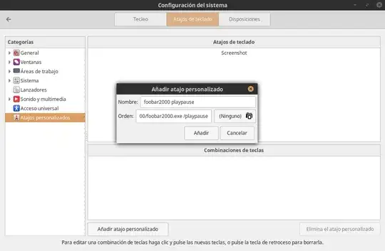

Before Snap, it was quite easy to overcome this using Wine commands like this:
and adding that command as a keyboard shortcut:
So,
Is there a way to do something like this with Snap software?

The command which foobar2000 shows you that the executable is located in /snap/bin. To define your shortcut to start/pauze playing, use the command
/snap/bin/foobar2000 -playpause
