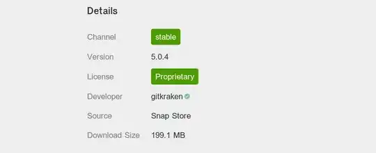

Ubuntu is slowly moving towards snaps. So, sometimes it becomes a little bit difficult to guess whether a package installed from Ubuntu Software is a deb package or a snap package. Also, it is to be noted that some packages are available via snap as well as apt, thus Software Center can have two entries for identical apps. It's better to look at the bottom of app in Software Center to identify whether it is a snap package or a package installed via apt. For example, here GitKraken, it is only available via Snap, since apt search gitkraken returned no results and looking at the bottom of app page:
