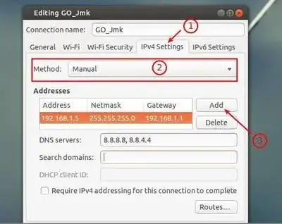

If you question is about the network, your answer is 'Yes'. You can set static IP on both your laptop and your PC. To do so, use network-manager:
  1. Open Network manager
  2. Edit LAN
  3. Go to IPv4 Setting Tab
  4. Set method to Manual
  5. Set IP address.
e.g. set 192.168.1.1 for the PC and 192.168.1.2 for laptop.
Then you can use any network remote connection tool to access PC from laptop of vice versa. For example: SSH, AnyDesk, VNC Viewer, etc.
