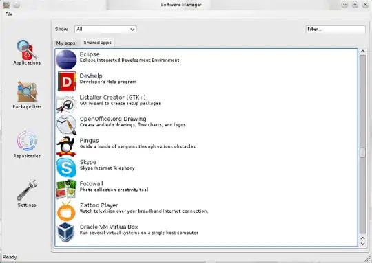

Alternatively you can try
  1. Autopackage
  2. Listaller enter image description here

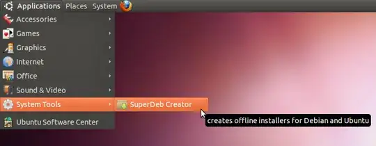

You might consider using SuperDeb Creator. Ubuntu has no practical tools natively installed.
SuperDeb Creator is a program that creates SuperDebs that can be installed offline, shared on CDs, DVDs, etc... Their main goal not only to provide an easy-to-use installer to users that don't have an internet connection, but also to provide an easy way to share software in a de-centralized way, reducing dependency on online software repositories.
Source
Can create a SuperDeb for Debian 5.0.7, Ubuntu 9.10, 10.04, 10.10, 11.04 (alpha 1 or above)
Download Page
