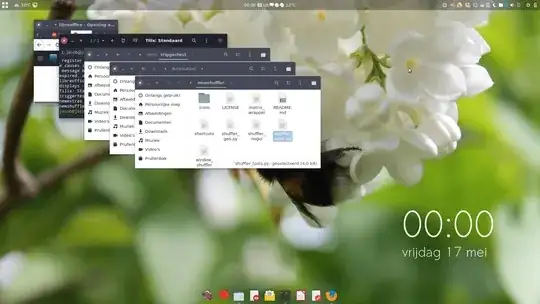

You found a workaround, but it seems quite a hassle. Alternatively, you can set the script below under a keyboard shortcut. It will move all "normal" windows to the left-over monitor, arranged like in the image below, so ready to pick the window you want to work with:
The script

Setup
  1. Copy the script into an empty file, save it as collect_windows.py
  2. Create a shortcut, running the command:
    python3 /path/to/collect_windows.py
    (Go to Settings -> Devices -> Keyboard -> Custom Shortcuts, click +)
That's all
