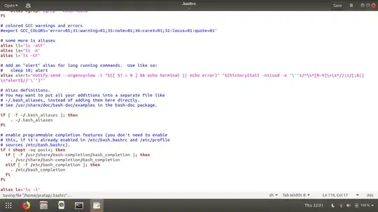

  1. Created a alias for ls -l as ls in ~/.bashrc file:
    screenshot

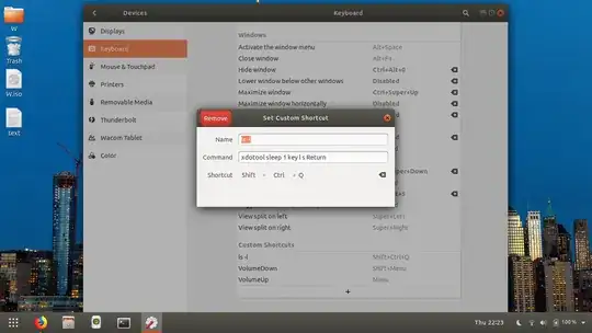

  2. To type ls and a key press of Enter, used xdotool sleep 1 key l s Return as a command for custom keyboard shortcut:
    screenshot

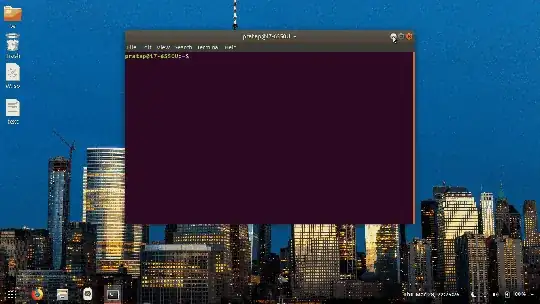

  3. Result, when I press the shortcut key combo:
    screenshot
