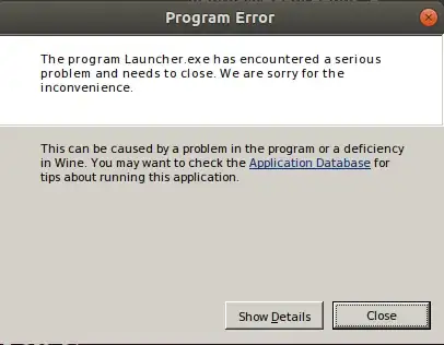

I tried i386 structure, Windows compatibility 7+ and many more but it gives an error when opened.
Program Error
And also i can't run this command:
sudo apt-add-repository 'deb http://dl.winehq.org/wine-builds/ubuntu/ bionic main'
But when i try it gives an error "The repository 'http://ppa.launchpad.net/wine/wine-builds/ubuntu bionic Release' does not have a Release file.
N: Data from such a repository can't be authenticated and is therefore potentially dangerous to use.
N: See apt-secure(8) manpage for repository creation and user configuration details."
Also i have game program error details:

System information:
    Wine build: wine-3.0 (Ubuntu 3.0-1ubuntu1)
    Platform: i386 (WOW64)
    Version: Windows 7
    Host system: Linux
    Host version: 4.18.0-16-generic
What can i do?

This ppa is obsolete according here to add the proper one according the announcement in the mailing list you should:
wget https://dl.winehq.org/wine-builds/Release.key
sudo apt-key add Release.key
sudo apt-add-repository 'https://dl.winehq.org/wine-builds/ubuntu/'
