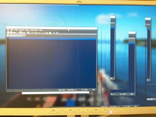

I am using two different Lenovo laptops and even two different Ubuntu-MATE versions 16.04 and 18.04, yet ever since I started with Ubuntu, I suffer refresh / repaint problems (on a multitude of monitors and docking stations, so let's not blame those...)
screen photo
If I switch to the next workspace (virtual screens) and back, these artifacts are gone. If I move a window slowly over it, it's also gone. Basically most things triggering a repaint makes it gone. Hastily shaking windows around tends to create them.
