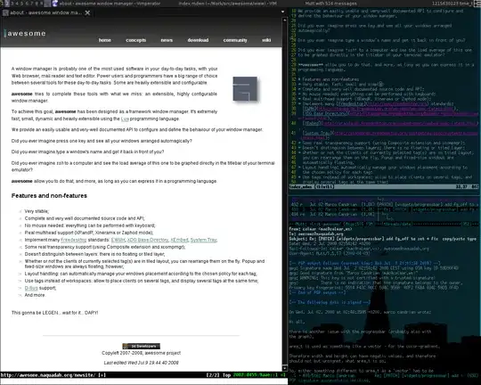

Description - Highly configurable window manager for X. It is primarily targeted at power users, developers and any people dealing with every day computing tasks and want to have fine-grained control on its graphical environment. awesome is very extensible and programmable using the Lua programming language. It provides an easily usable and very-well documented API to configure and define the behavior of your window manager.
Windows Manager Type - Tiling Windows Manager
Properties - Lightweight, Increased Efficiency (Less Resource Hungry), Little to no Visual Effects
Install - sudo apt-get install awesome
Screenshot

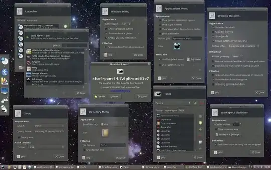

XFwm
This is the windows manager that is used by the Xfce desktop environment.
To install xfce, sudo apt-get install xfce4
If you want just the WM, sudo apt-get install xfwm4
To use in Unity-2d: edit /usr/share/gnome-session/sessions/ubuntu-2d.session changing DefaultProvider-windowmanager=metacity to DefaultProvider-windowmanager=xfwm4
Add file /usr/share/applications/xfwm4.desktop
to contain:
[Desktop Entry]
Type=Application
Name=Xfwm4
Exec=xfwm4
NoDisplay=true
# name of loadable control center module
X-GNOME-WMSettingsModule=xfwm4
# name we put on the WM spec check window
X-GNOME-WMName=Xfwm4
# back compat only
X-GnomeWMSettingsLibrary=xfwm4
X-GNOME-Bugzilla-Bugzilla=GNOME
X-GNOME-Bugzilla-Product=xfwm4
X-GNOME-Bugzilla-Component=general
X-GNOME-Autostart-Phase=WindowManager
X-GNOME-Provides=windowmanager
X-GNOME-Autostart-Notify=true
X-Ubuntu-Gettext-Domain=xfwm4
(Instructions taken from http://ubuntuforums.org/showthread.php?t=1877405)

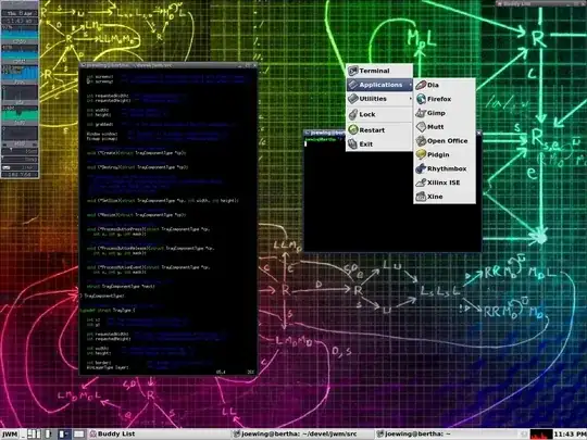

jWM
Description - Low resource Window manager ideal for older PCs. It uses a minimum of external libraries, thus very little memory, includes virtual screens, menubar and root-menu popup.
Windows Manager Type - Stacking Windows Manager
Install - sudo apt-get install jwm
Screenshot
