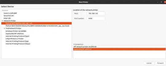

I suffered for a long time with setting up the pantum BM5100ADW printer. The test page prints, print jobs go through but the printer does not print. Reloading or disabling cups-browsed did not resolve the issue. Only setting a fixed IP and connecting via AppSocket helped. enter image description here
