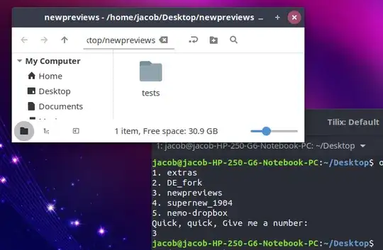

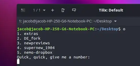

How it works in practice
  1. In terminal, in the working dir, run "o" (as a command)
  2. The content of the current directory is listed, numbered. Pick the number and the item is opened:
Set up
...is easy:
  1. Create, if it doesn't exist yet, a folder named "bin" in your home directory
  2. Copy the script into an empty file, save it as (literally) "o" (no extension), and make it executable
  3. Log out and back in and start using the command by just typing
    $ o
    in terminal
