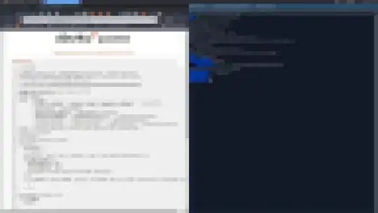

When I run the script from the terminal, the result is as expected. The screen is locked with the correct image (including the dark rectangle). Correct lockscreen
However, after activating xss-lock with xss-lock -l /path/to/script/lock.sh and then closing the lid, the script runs but the rectangle is not drawn, leading to sometimes unreadable lockscreen text. Incorrect lockscreen
I've tried modifying the script so that it doesn't delete the screenshot that it takes and edits, but the screenshot contains the dark rectangle. I think it's something weird with ImageMagick, since the pixellation and the rectangle drawing are specified in the same command, and the pixellation occurs but the rectangle drawing doesn't.
